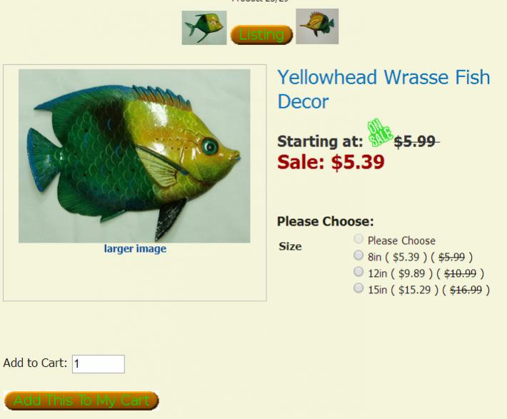

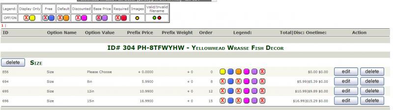

I have my attributes set up exactly as shown in your screenshot; however, I am getting an 'Out Of Stock' next to my display-only attribute. This attribute has not been added in the SBA page for any product. Do I need to add a stock level to a display-only attribute? Or am I doing something wrong?

The version I placed out for testing (in a previous post on this thread) should resolve the issue you described.
