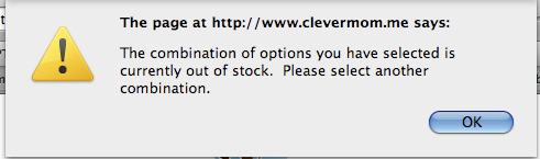

The problem is that right now, if you go click "add to cart", if you haven't chosen ANY options, you get the following alert:
Attachment 6254
and are then forced to make actual options which then adds them to your cart.

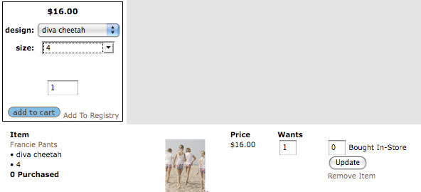

Now if you were at that same page but instead of clicking "add to cart" you clicked "Add to Registry", you wouldn't get an alert, and non-options would be added as show here:
Attachment 6253
There is no 'TEXT' option so I'm assuming this is just the default...it SHOULD look like this:
Attachment 6252
