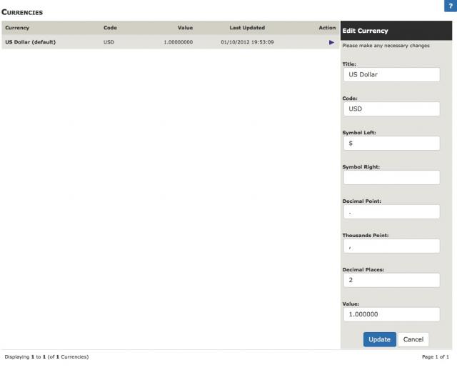

    I have that set at 2 decimals. Should it be set at 0?

    As posted in a previous comment, the Admin>Localization>currencies is set to 2 decimals.
