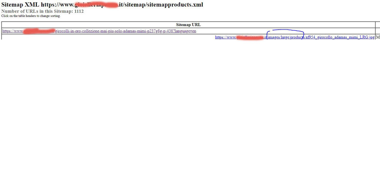

Hi everyone, I noticed that in the product sitemap it puts the url to an image that doesn't exist ... I use Image Handler 5
see image here
https://i.postimg.cc/kGf6BFW0/Cattura.jpg
can anyone help with this error?
thank you

5 Jun 2020, 10:57 AM
#1960
hasher avatar
hasher
New Zenner
Join Date:
Sep 2011
Posts:
77
Plugin Contributions:
Re: SitemapXML v.2
Hi all,,
Having some trouble using SitemapXML . It only seems to generate links for 5000 products and now to has a HTTP 500 Internal Server Error when trying to generate a new sitemap.xml. I have seen other Zencart sites that are using SitemapXML but have over 5000 products , how do I activate this feature ?
Hash
